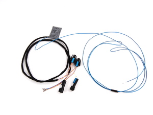

6/28/2011 Edit: Here is a full DIY It uses the E39 wiper stalk that has an extra button to use. This will produce a cleaner look, but cost a little more in parts.
I just finished this mod and it works. I now have multi-function controls (radio/phone on left and cruise on the right) plus track mode on a new button I installed. The car is a 2005 ZCP.
It does require a some new wiring. You need the upper cover with the multifunction buttons and either the retrofit wiring harness, or you can build one yourself with 4 wires with blade connectors.
To find the basic information on how to do this mod, search on "multifunction retrofit". The best links I have are
This is the PDF file describing it (also can be found other places):
http://www.box.net/shared/0sb5rm740s?sid=GAN_476520590
Here is an excellent DIY showing how to do the basic retrofit (w/ pics)
http://forum.e46fanatics.com/showthread.php?t=544160
This post explains how to make your own wires.
http://forum.e46fanatics.com/showthr...ghlight=x10170
Here is what is different for the ZCP:
On a standard M3 pins 8,9 and 10 of connector X10170 (green connector found inside the cover below the steering wheel) are used for the multi-function panel. On the ZCP pin 8 is connected to a wire that enables/disables the M-track mode and 9 and 10 are not used. For this mod, remove the wire on pin 8 so you can connect pin 8 to the DME/DDE to enable the cruise (per the standard retrofit). To use the track mode, I added a momentary push button switch ($2.75 at radio shack) that connects the wire formerly connected to pin 8 to ground. The ground used is from pin 7. I mounted the button by drilling a hole in the left side of the cover below the steering wheel. The button is just below the turn signal stalk.
There is nothing special about this location except it is close to where the wire terminates. You can run the wires to mount the button in the dash, the ash tray, etc. I was thinking about getting one of those old floor mounted dimmer switches and put it on the left side. After all I have an SMG and my left foot needs something to do. Also, an
illuminated button might be nice. Pin 10 has power.
Well, I'm off. I going to cruise around town with track mode enabled as I change radio stations with abandon.
7/10/10 Edit: Instead of making your own wires, part #61120016012 can be bought for about $25.
