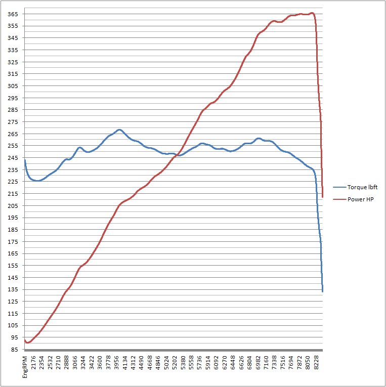

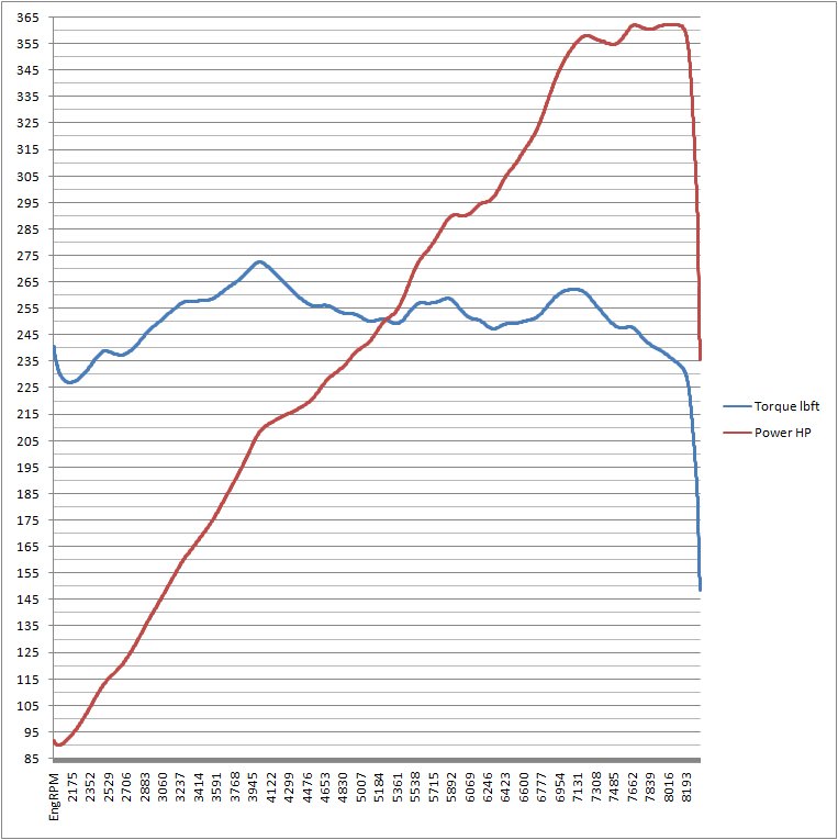

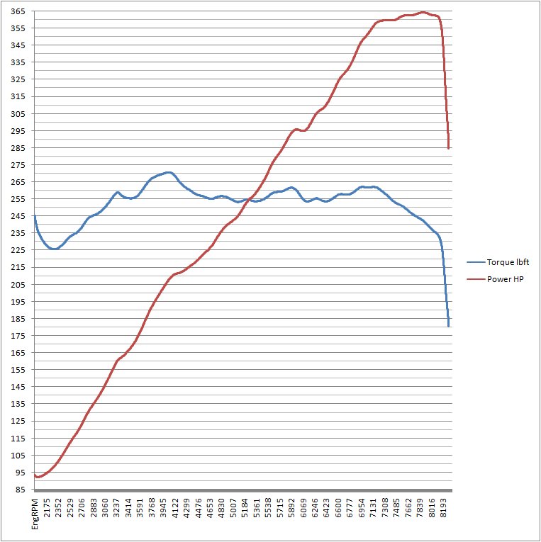

Here's the dyno results for 2008 BMW M3 and Evo Sport Power Pulley on 91 octane gas.
The Dyno: Dynapack 4000 Chassis Dyno (wheel hub attachment).
RPM Range: 2000-8400
Max Torque: 268.5 ft/lbs @ @ 4022 RPM (Run-3)
Max HP: 366 @ 8148 RPM (Run-3) - +7hp Gain
Other graphs: Run-1, Run-2, Run-3

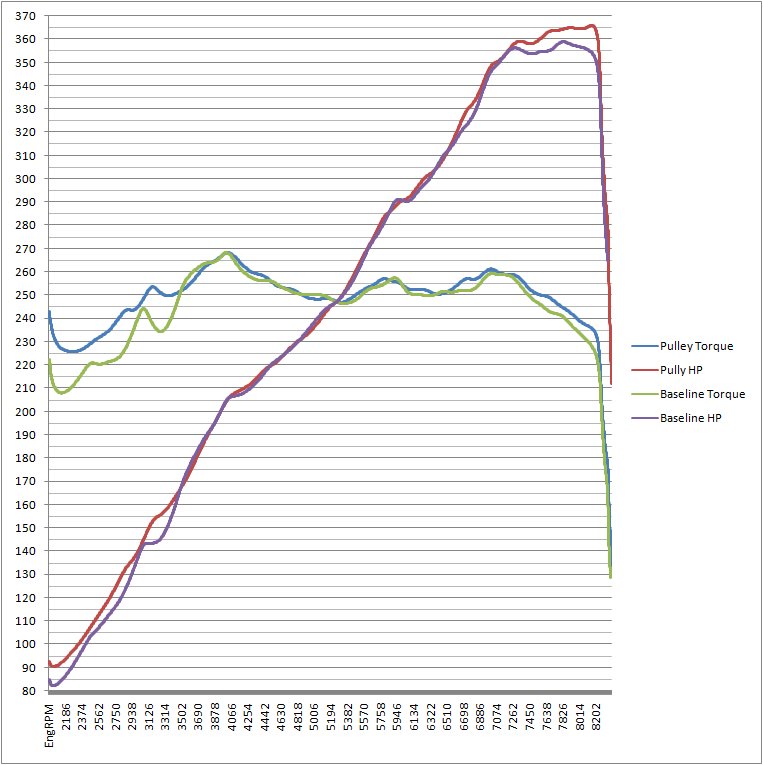

Evo Sport Power Pully
Stock baseline vs. Evo Sport Power Pulley

Notes:
* Ramp time: 2.5 seconds per 1000 RPMs.
* Gear Ratio: 3rd gear.
* Fuel: 91 Octane Unleaded (R+M/2)
* Traction Control: Disabled
* Onboard electronics and running lights: Disabled
* Air Conditioner: Disabled

Thanks. I like the low end torque increase. I bet that that can be felt.

wow buncha low end tq niceee

great job on the low end tq increase! very nice.

what was the baselin hp of the m3 . do u think this mod is worth it vs other pulley manufacturers? and is it only a 7hp gain ur saying vs their posted 21hp gain???
