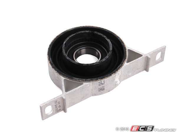

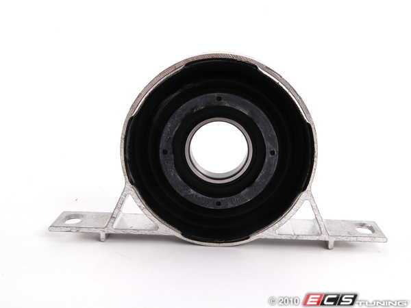

can anyone confirm if parts #8 and #11 are included with part #7?
07 Center Mount, aluminium 1 26122282495 $79.46
08 GROOVED BALL BEARING D=55/D=30 1 26121225071 $26.16
11 INTERMEDIATE RING D=30X36X1,0-CRH 1 26117514120 $2.18
from these pics, it looks there is a bearing included in #7. but im not sure if thats #8 or #11.

Tischer bmw confirmed that item #8 (Grooved ball bearing) is included in item #7 (Center mount). item #11 (Intermediate ring) is not included.
Included:08 GROOVED BALL BEARING D=55/D=30 1 26121225071
Not Included:11 INTERMEDIATE RING D=30X36X1,0-CRH 1 26117514120
