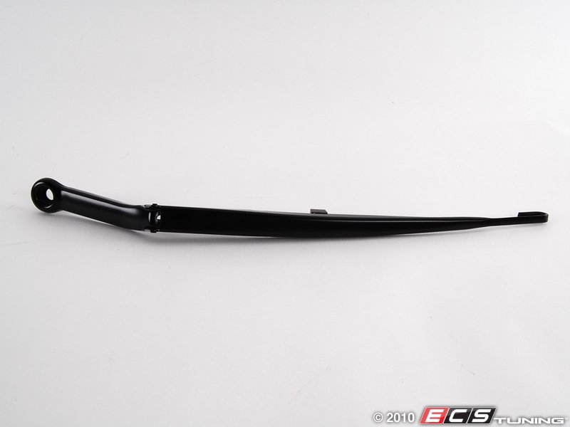

Originally Posted by Braymond141 View Post
The answer was already given. You need to bend the wiper arm back into the curve it originally had. The actual arm of the system, not the blade portion.
See the arm curvature? Bend yours back into that curve.
Hello
I just replaced my wiper blades and found the same problem as Kaveh. the blade on each side does not touch the windshield in the middle at the bottom of the windshield. We tried two sets at the dealership. Also, the driver side touches the passenger side arm. My previous ones worked just fine which were the originals with the deflector shield.
Any further info? I would like to be sure before I try and bend anything.
Thanks!

Default Re: FYI: BMW is now selling new style wiper blades for the M3 that function at all sp
Originally Posted by loayoweis View Post
Hello
Thanks!
Regards,
Loay
I had the same issue. Middle part of driver side would miss. I bent the wiperarm slightly. It fixed the issue. These blades are better than the old type.
Thanks I bent my arms slightly and now they don't miss the middle. I am simply not sure if my bending is accurate to have an even distribution of the wiper. Time will tell.
